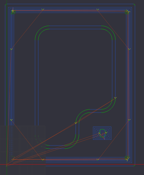

Just to add to this. I just ran the gcode through AL v0.8.3 and opened the result in CamBam.
In 0.8.0+ the user has the option of using a raw probe file (RPF) which keeps the probing separate from the etching (this has many benefits).
Using the RPF in the AL v0.8.3 process, CamBam shows me this:
- 083ALwithprobefile.PNG (55.78 KiB) Viewed 22555 times
so yes, it looks good to me.

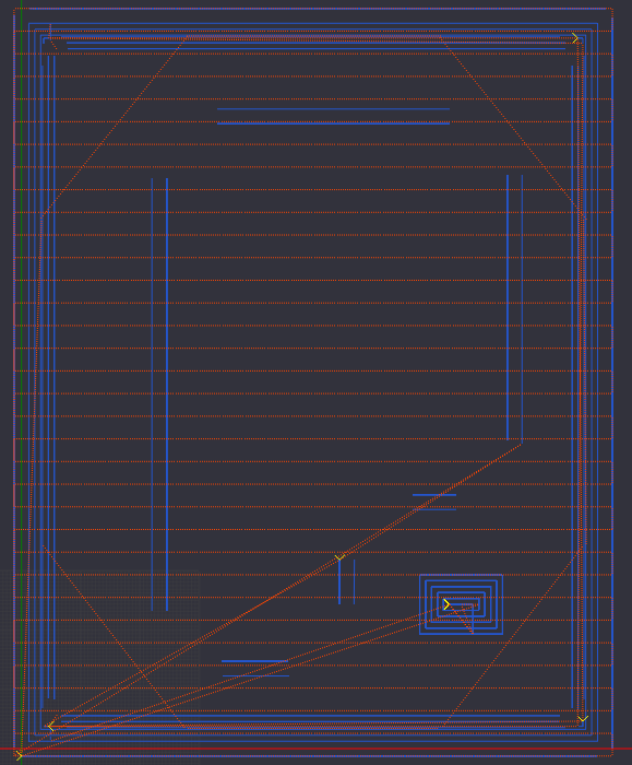

However, if I try again without using the RPF, I get this:
- 083ALwithoutprobefile.PNG (59.92 KiB) Viewed 22555 times
As you can see, the Arcs are missing, which is confusing since the Arcs exist in the gcode file. So why doesnt cambam display them?
After much head scratching I came to the conclusion that arc radius' need to be very very precise with respect to the centre of the Arc (defined by I and J) and the start / end points of the arc, otherwise your controller will complain. Cambam probably encountered the same issue and decided not to display any arcs here. Mach3 may or may not have the same problem because each controller has different tolerances with respect to arcs.
