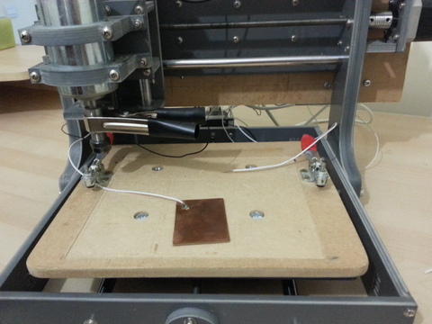

Anyway, I do a lot of probing for my software product which essentially means that the tool needs to be grounded.
This is my old setup:
spindle as a probe with clip around the colet
The problem with this clip is that:
1. I can and have forgotten to attach the clip meaning there is no continuity between the tool and surface and therefore the tool often breaks and embeds itself in the workpiece and puts a big hole in the surface.
2. I can and have forgotten to remove the clip after probing and before the spindle starts up. This tends to grind away at the colet as it spins at ~8000rpm, plus it makes a horrific noise.
The only part of the spindle which offers continuity to the tool is the nut at the top.

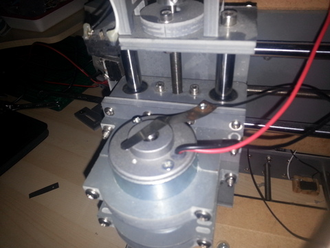

The solution then:
spindle as a probe with a spring
Here I have used an old feeler gauge to act as a spring to contact the nut. A wire is connected to the spring which is then grounded.
So, the tool is always grounded now which eliminates my problems of forgetfulness. :)
I realize that this is a solution which is specific to my ZTW spindle and your spindle may be grounded anyway but it might interest you nonetheless.

That is a very good idea - I just might do something like that myself.... just have to insulate the feeler gauge from frame.
Ken H>
Re: ZTW spindle grounding
Ken,
You may not have to insulate it from the frame. Use a multimeter to check and see. It may have contact now, but it is un-reliable due to the possibility of an interruption because of the lube in the bearings. By adding the strap as shown, you will be increasing the reliability of the connection.
