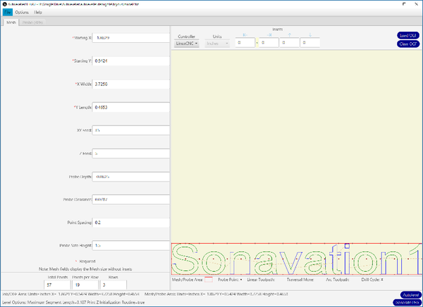

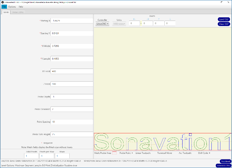

It took a bit longer than I thought but it should work as expected now, i.e. accepts any number and variation of leading and trailing dots in values and doesnt require the "follow-on" (Modal) GCode to be stated on every line, such as G02, G01 etc. Here is the original and unmodified model2.txt file loaded in the updated AE: One thing to note is that there is no units specified in the file so AE has assumed wrongly that you are using millimetres and so all the probe setting default to millimetres too. To fix this just add a G20 at the end of line 2 like this:
Probe settings will now be more appropriate for inch mode:
N0010 G40 G17 G90 G70 G20I have a couple more changes to make but you should get this update in version 9.3 ASAP.
