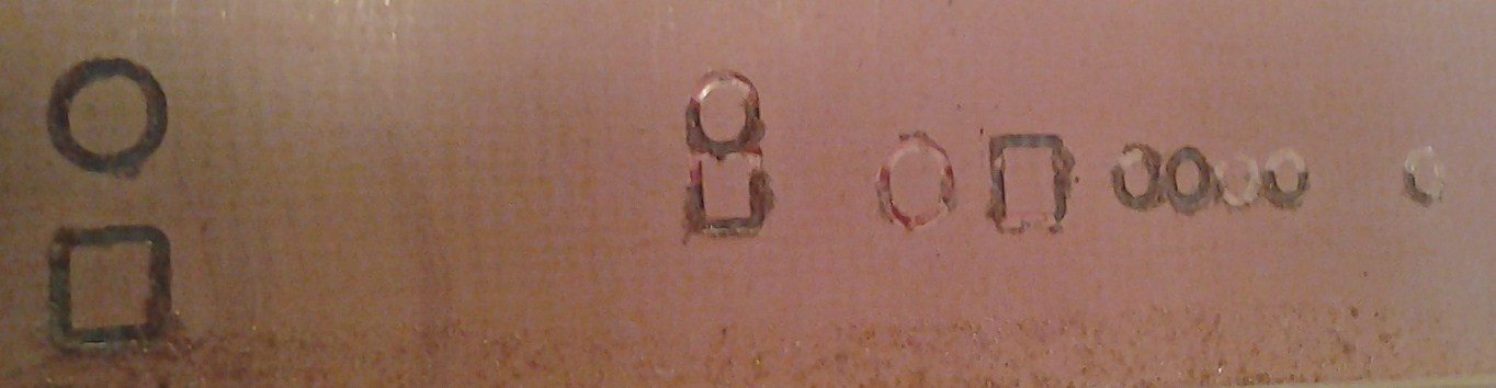

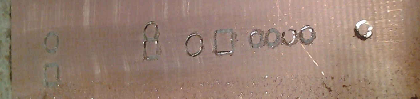

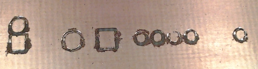

here are pictures of how it is cutting. I stopped it before it ruins the entire pcb blank

I think this could be for a number of reasons. A possibility could be an inaccuracy in the probing values retrieved, again the reasons for this could be numerous, could be something to do with anti-backlash nuts on your axis or some setting in Mach. I remember a problem a while ago that affected a few individuals where AL didnt like the probe values when fed back to AL because some values on the X and Y axis were slightly off. I adjusted AL to compensate but it would have been better if the machine had been 'tightened up' rather than the software working around the problem.
I did notice a few of these discrepancies in your log file but I'm not sure if its enough to affect anything. From your log file:
4.92941,0.44475,0.00461
4.54935,0.44477,0.00373
4.17032,0.44475,0.00302
3.79118,0.44477,0.00356
3.41198,0.44477,-0.00143
3.03290,0.44475,-0.00126
2.65381,0.44477,0.00143
2.27473,0.44475,-0.00121
1.89559,0.44477,-0.00027
1.51645,0.44475,-0.00077
1.13736,0.44477,-0.00143
0.75817,0.44475,0.00005
0.37914,0.44477,0.00164
-0.00000,0.44475,0.00488
A couple of Y values are 0.44475 wheres they should be exactly the same as the others (0.44477). X and z could be worse, not sure. Again, dont know if these minor differences are enough to cause a problem.
Another thing which you could try is to increase the cut depth. I noticed your cut depth was set to .002", maybe try .004" and see if that helps.
