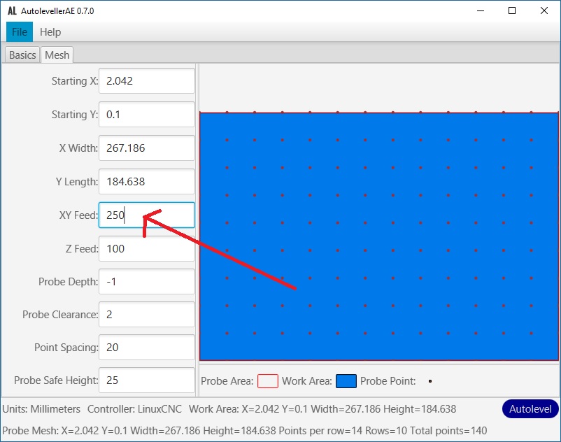

But the problem I don't have in the speed of the Z axis, it is in the speed of the axis Y and X, if you see the video you will see that it doesn't work in a stable way, even the free version of AE
Re: The autoleveller no work in my machine CNC 3040 USB

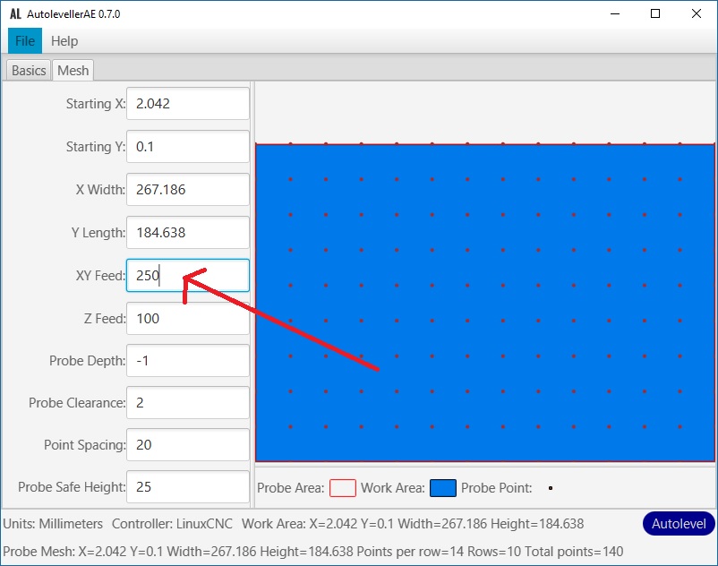

Sorry for the late reply.

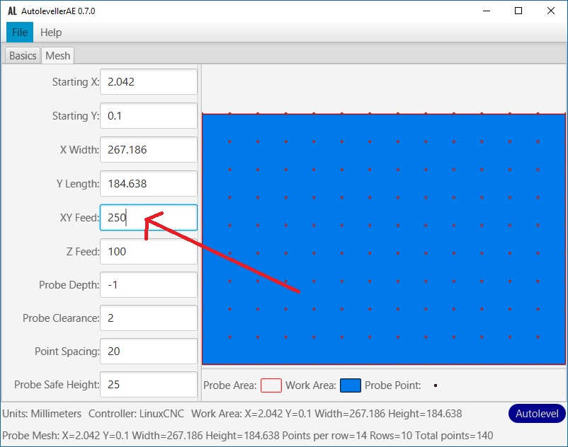

This is the free AutolevellerAE 0.7.0 (http://www.autoleveller.co.uk/download/): Forgive me if I dont understand, but is this what you need? You can change the XY feed to whatever you want.

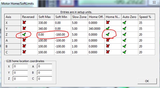

It sounds increasing likely to me that your Z axis is incorrectly set in Mach 3. This is how Art saw the situation as well I believe.
First, I think you need to check the 'reversed' setting for the Zaxis in Mach3, like this:

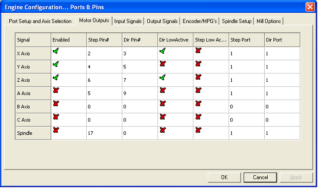

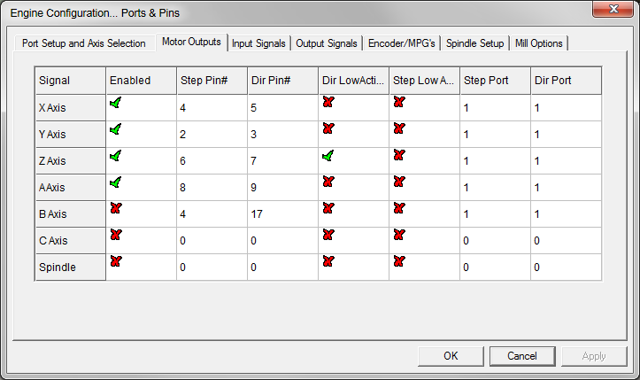

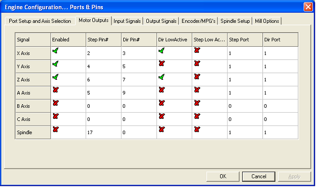

You also need to check the settings in motor outputs. Depending on how you wired your CNC, you may need to check the 'Dir Low/Active' of Z axis as well. This will cause your Z axis to down on a negative command and up on a positive command as it should.

This way I have configured my machine, and what I don't understand is that with Gcode without autleveller it works welldaedelus wrote: It sounds increasing likely to me that your Z axis is incorrectly set in Mach 3. This is how Art saw the situation as well I believe.

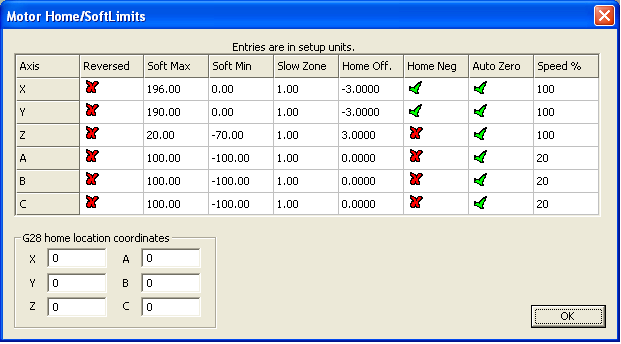

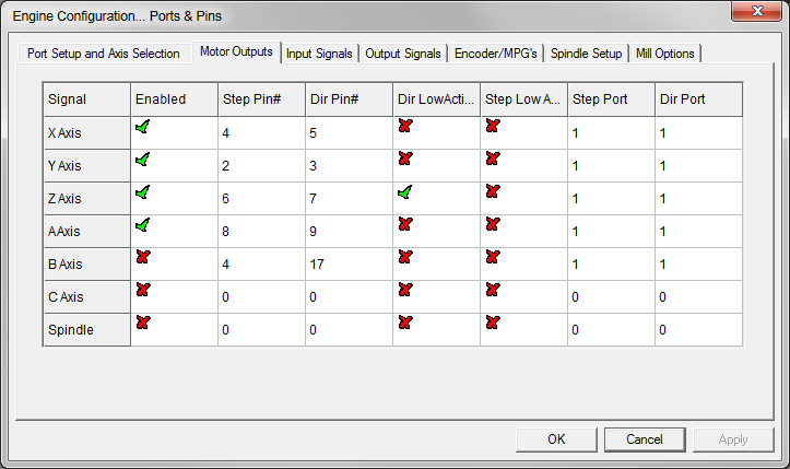

I have set the machine that zero is on the front left and the Z axis up.daedelus wrote: You also need to check the settings in motor outputs. Depending on how you wired your CNC, you may need to check the 'Dir Low/Active' of Z axis as well. This will cause your Z axis to down on a negative command and up on a positive command as it should.
I make the test of sending order negative Gcode (G0 Z-3) and the Z axis and it works fine.
I upload the image of how the engines are configured
I will check my own machine tomorrow but just to say...

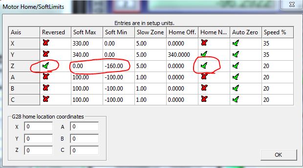

In the 'Motor Home/Soft Limits' screen, try marking the 'Reversed' field for Z axis, see if that makes a difference.
The only difference is the probing bit (all the G31's etc.) so the problem is something to do with the probe. But, from your video, the Z axis seems to be going in the right direction fine. Maybe the probe stage is storing the wrong numbers on each point, causing the calculations to be wrong. Just a thought.This way I have configured my machine, and what I don't understand is that with Gcode without autleveller it works well

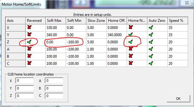

I have modified that parameter and it is shared equally.daedelus wrote: In the 'Motor Home/Soft Limits' screen, try marking the 'Reversed' field for Z axis, see if that makes a difference.

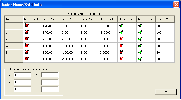

Apologies for my lateness,

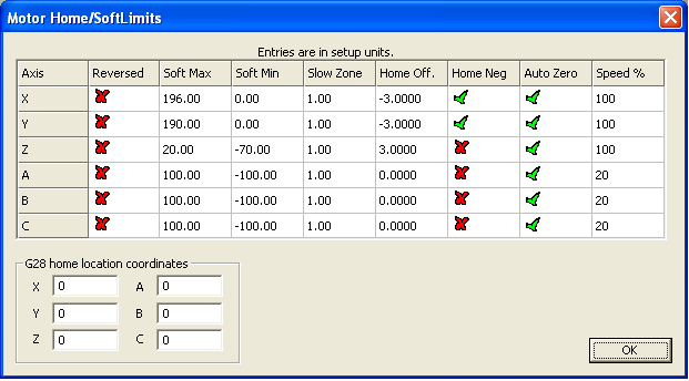

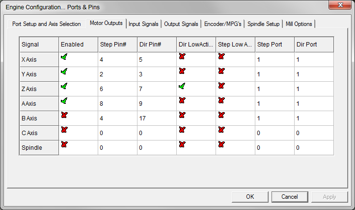

Here are the screengrabs I promised taken directly from my Mach3 setup: As you can see I dont have the 'reversed' field checked for Z either but 'soft max' is set to 20 for Z. If you do similar, you should not need to lower the 'probe safe height' in the autoleveller settings. (Probably a unprofessional way to do things, I am not a Mach3 expert though)
I cannot see much difference in our setups though.

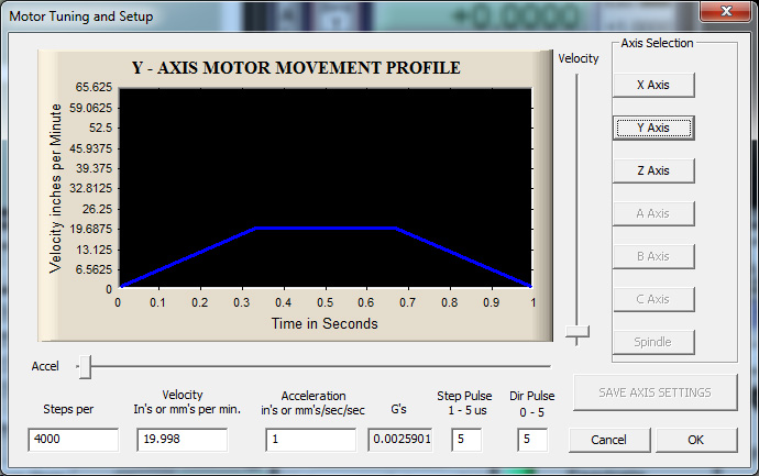

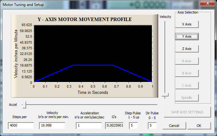

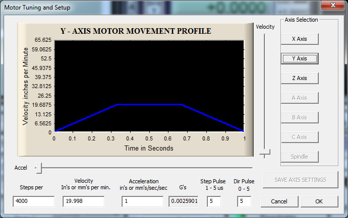

I did not see that in the video. But given this, maybe the mach3 'motor tuning'? needs adjusting, these things:I don't know if you'll see it in the video but when the machine do the probing routine, sometimes all three axes move at the same time, I think that should not be so
