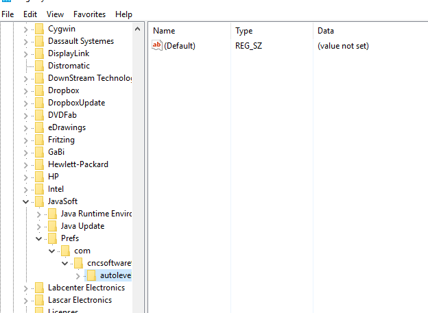

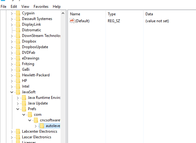

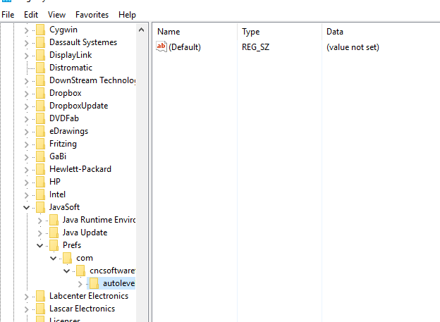

I've tried it again this morning and still get the same error, Will not open file, This time I went through the registry again and found the that if I delete the bit in the attached picture it works normal
Hope this helps in locating my issue
