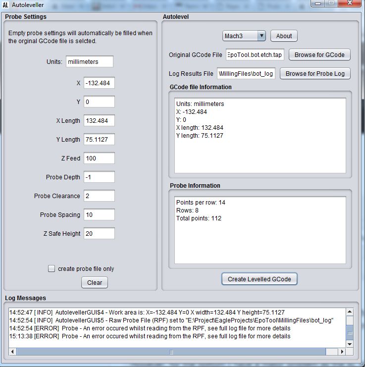

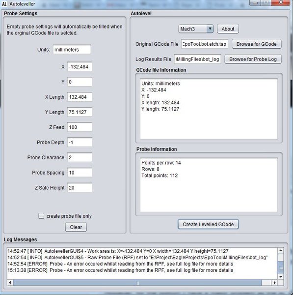

first of all, my thanks to James for this great and helpful software. I've downloaded it from member's section and am now using the 0.8.7 version for leveling my source gcode files for which I have previously created a probing log file. This works fine for top side of my PCB and the result is, as usually, great.
However, when creating a leveled sourced file for the bottom from a probing bot_log file created in advance on my machine, I seem to have a major problem, as the AL shows an error in its log window (see attachment) and refers to its autoleveler.log file for additional info. I attach this log file as well. I also attach the critical bot_log probing file.
My understanding from what I see in the autoleveler.log file is that there is a problem with ranges in the probing log file. Please note, that if done in one go (probing and milling) there is no problem. However, I would have a separate probing file for later use.

Re: A (rare) Autoleveler Bug?
HI again,
I did some debugging and, using the debugger, narrowed down the place in the code where the exception occurs to probe.java file. It happens in the function public static SimplePoint3DCNC[][] createProbePoints(List<SimplePoint3DCNC> listPoints).
Hi again,
I did some further research and I came to the conclusion that this behavior (AL not able to read log file which was created with coordinate system being rotated) of the AL is not a bug, but is rather a side effect due to rotation of the coordinate system I set in my machine (G68) in order to mill my double sided PCBs. The actual problem is, that AL is not designed to take into account this rotation. So, this thread can be closed.
