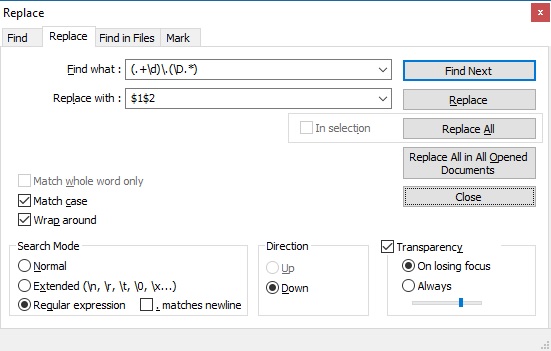

To remove the trailing periods, you can load the file in notepad++ and press ctrl+h for find and replace. Then select regular expression and enter "(.+\d)\.(\D.*)" in the find box. "$1$2" in the replace box. Click "replace all" and it should remove the offending periods. Do this twice or more to remove the remnants where lines contain more than 1 trailing period.
If anyone is curious about the regex, "(.+\d)\.(\D.*)", in English it says "match any line with any 1 or many characters followed by a digit, followed by a period, followed by anything which isnt a digit, followed by any number of any characters". The parentheses group the parts of the line so that we can refer to the groups in the replacement. So "$1$2" just says replace each match with the contents of group 1 followed by the contents of group 2, i.e. the same line without the offending period.
