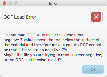

Hi
The AutolevellerAE V0.9.5u1 gives the following error message when I tried to load OGF. I'm sure there is a negative value of Z axis. Also the same file was accepted free of error when I use Autoleveller V0.8.7.

This error code was added to the latest revision to find just such a scenario.
Previous versions didn't have it.
Open your gcode file in any basic text editor to verify the presents or lack of negative Z movements.
Chances are there are no negative Z's

As Art said, this error popup was added recently to warn users of the probable problem rather than just crashing abruptly.
If you cant find any problems with the OGF though, maybe paste the first 50 or so lines of code here and Im sure we will be able to find the problem and provide a workaround or solution.

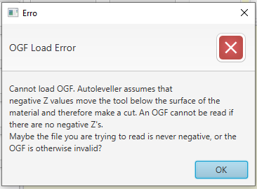

Hi!
Same issue here release 0.9.5u2.
OGF generated by Fusion360
Best Regards
Antonio
