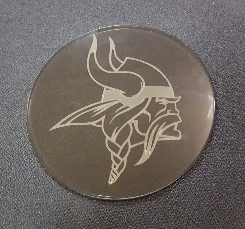

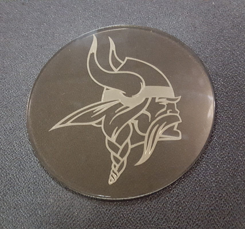

I just purchased AutolevellerAE 0.8.5 and gave it my first trial run. The end result turned out great (I attached a picture), but it took quite some work to get it there. The main problem was that the autolevelled gcode had trailing periods on many lines like:

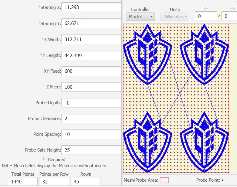

Another issue was that the starting point generated when I loaded an OGF was way off to the side of the stock. As a result, I ended up just manually inputting the starting point and the size of the stock and generated a PFG that way - which worked great.

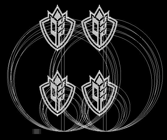

Looking at the Gcode file, the only thing that appears odd to me is that any position that does not contain any digits past the decimal point ends with the decimal point itself eg X512. as an example. I am used to seeing digits beyond the decimal point even if they are 0.
Next just for grins and giggles, I opened the file in Sheetcam and was very surprised to see a bunch of extraneous circles! (see attached jpg)
They all appear in Sheetcam on a layer noted as Tool 3 0.150000 deep. I then attempted to do a simulation on the file and immediately got the following error: "Post processing...
Warning: WARNING: Feed rate is zero
Post processing completed with 1 warnings"
This makes no sense as there are several F1000 and F700 commands through out the file! But is is a mystery to me why this will not simulate in two different programs!
Also, AE may be getting upset by the use of the G17 codes, but James will have to answer that one.
And as I am not a user of Mach, I cannot do any sort of debugging there.
Sorry, but maybe some of my ramblings will give James an idea as I am hoping a solution can be found and would like to know why it won't work!

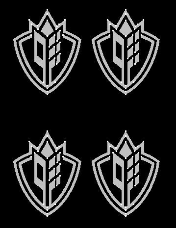

OK, we have now had some success! Went to bed last night and thought about it and this morning started eliminating sections until we got down to a working solution.
To make a long story short, the (2D CONTOUR1 2) routine is the culprit! As you can see from the screenshot in Sheetcam, by eliminating these routines, it eliminated the extraneous circles!
When I tried to load just (2D CONTOUR1 2) it bombed and I haven't gone through that line by line to see the problem, but based on my experience, I would bet those circles are not wanted anyhow??? One thing I have found, is that eliminating this section also eliminates all references to G18 so there may be something to that also??? I don't know. I will leave it up to you to figure that one out.

I think the main problem here is Fusion 360 because it is designed for 3D modelling I think, and inserts lot of GCode swapping planes and changing Z's. The viking head turned out well so Fusion 360 obviously works sometimes when the trailing periods are removed from the gcode. I dont know fusion 360 but is it possible to design in a way which does not cause the problems, now that we sort of know the issue?

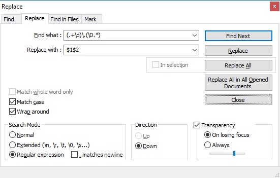

To remove the trailing periods, you can load the file in notepad++ and press ctrl+h for find and replace. Then select regular expression and enter "(.+\d)\.(\D.*)" in the find box. "$1$2" in the replace box. Click "replace all" and it should remove the offending periods. Do this twice or more to remove the remnants where lines contain more than 1 trailing period.
If anyone is curious about the regex, "(.+\d)\.(\D.*)", in English it says "match any line with any 1 or many characters followed by a digit, followed by a period, followed by anything which isnt a digit, followed by any number of any characters". The parentheses group the parts of the line so that we can refer to the groups in the replacement. So "$1$2" just says replace each match with the contents of group 1 followed by the contents of group 2, i.e. the same line without the offending period.
