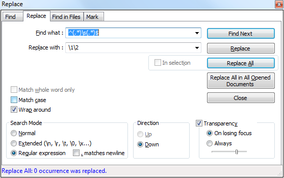

So, with your gcode open in your text editor (I recommend notepad++) use find and replace:
Find: ^(.*)\s(.*)$
Replace: \1\2
notepad++ remove spaces
Make sure the regular expressions radio button is checked
Clicking 'replace all' removes the final space on each line, so keep clicking 'replace all' until it says "Replace All: 0 occurence was replaced"
