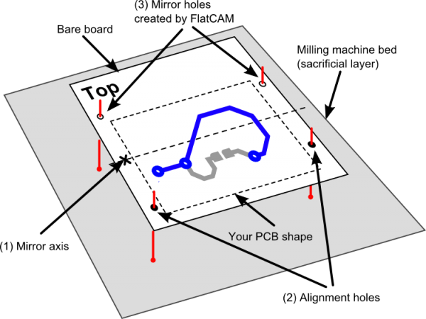

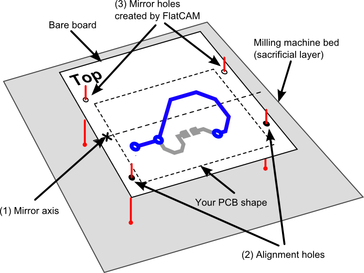

Yes, this happens when doing doublesided boards. The alignment pin holes get in the way when flipping the board around to etch the other side. There needs to be a way to avoid the holes?

I also etch before drilling. I use Flatcam to produce my G-Code files. I use Autoleveller to probe the board and then I etch the bottom first but before flipping the board over to etch the top layer, the alignment pin holes (4 of them) must be drilled. Once the board is flipped to the top layer, I use autoleveller to probe and hope it will miss the alignment holes.

I presume you have this sort of arrangment
http://3.bp.blogspot.com/-QV3vahlpamE/T ... _small.jpg from
http://woodworkerbcncrouterproject.blog ... lling.html?
If you 'touch off' the Y axis by 1/2" for example then your work area will be clear of the pins whilst still being able to align everything correctly when you flip. Is this correct / possible?

The alignment holes that I use are drilled in each board that I etch.
Why couldn't I change the XY coordinates under probe settings in Autoleveller to miss the alignment holes?

I too use tooling posts.
I use only two posts outside the work area but inside the machine envelope.
The posts are located along X = midle value of the axis range.
I position my design in the centre of the working range and then extract the milling info so that the machine bed and tooling posts match the extracted data. lipping along the mid value of the axis then simply flips data in machine space as well and this takes care of alignment.
As for probing and crashing into posts.. if they are outside the PCB area then the probe ought not even come close to them.
Thanks Zig. Thats exactly what I imagined.
If, for some reason, you cannot get your posts outside the PCB area. You can adjust the extents of the probing area and probe spacing in the Autoleveller settings to try and avoid specific points.
