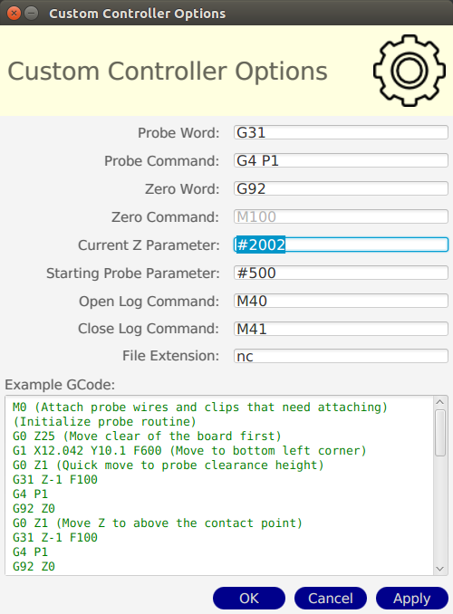

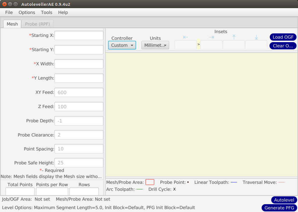

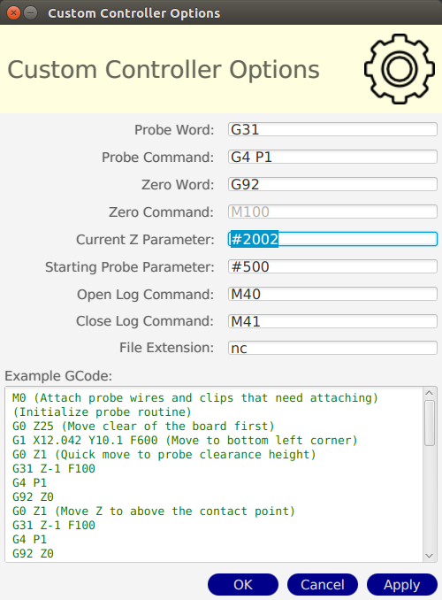

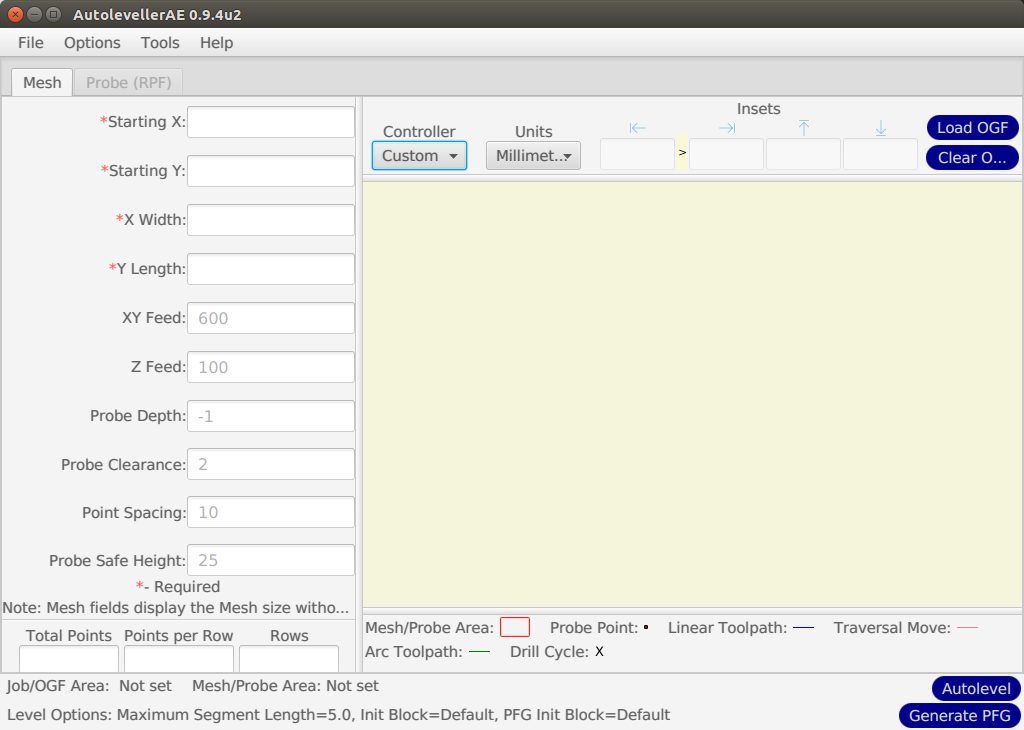

Re: Aircuts on Mach3 USB NcUsbPod
I was not 100% sure that pausing with G4 would work but it seems to work for some and i'm glad it works for you. Yes, it would be nice if you could add a smaller delay that 1 sec but I guess thats part of the GCode specification or Mach3 / USB controller as you say. Cant be helped.
As for adding the G4 command for each line. Does this not help?
Change controller to custom as shown here:
Now change the custom controller options in the options menu to something like this:
This should be the same settings as for Mach3 but with the added "G4 P1" probe command.
