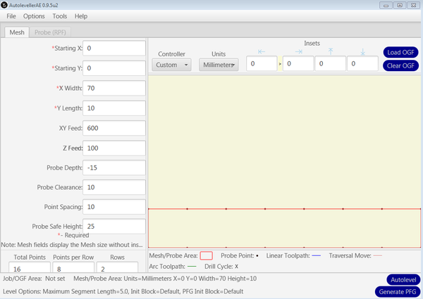

This is my current configuration
For M2002, I have a macro in the active profile directory with
SetVar(2002,getoemdro(802))
The PFG file is also attached
A snippet of which is pasted below

My question is why the G92 codes are not showing up after the M2002 command.
I would expect that after a probe detect the Z should be zeroed? correct?
