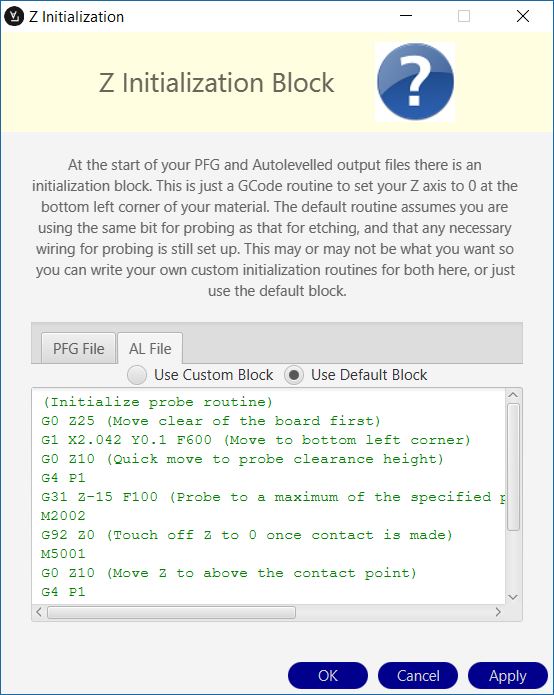

OK I think I know what you mean but I could be wrong. In the adjusted file, it will go to the bottom left corner and probe just once. This is because your machine still needs to know where Z 0 is for the first probe point even in the adjusted file, so that your probe mesh can be applied in relation to this point. This is the Z Initialisation block which can be accessed from AE by going to options -> Z initialisation routine:
It will only probe 1 time but if you cant/dont want to use this block of code and set Z 0 without using your probe, manually or some other way, you can easily disable it by clicking the "Use Custom Block" (which will remove the code completely) then just Apply and OK. When you generate the AL file again, this probe/initialisation code should be gone. Just remember to set Z to zero yourself in the bottom left corner.
