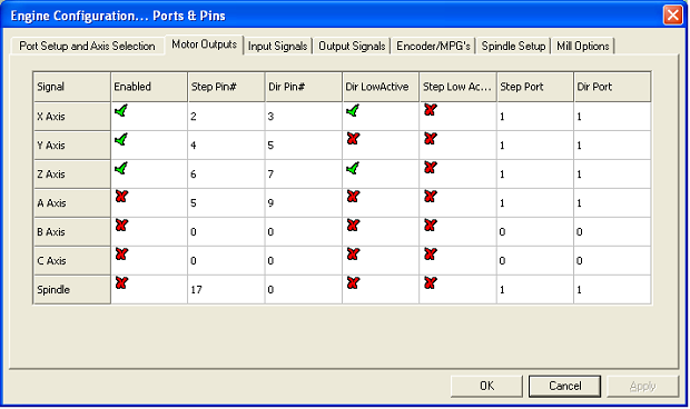

daedelus wrote:
It sounds increasing likely to me that your Z axis is incorrectly set in Mach 3. This is how Art saw the situation as well I believe.
First, I think you need to check the 'reversed' setting for the Zaxis in Mach3, like this:
This way I have configured my machine, and what I don't understand is that with Gcode without autleveller it works well
daedelus wrote:
You also need to check the settings in motor outputs. Depending on how you wired your CNC, you may need to check the 'Dir Low/Active' of Z axis as well. This will cause your Z axis to down on a negative command and up on a positive command as it should.
I have set the machine that zero is on the front left and the Z axis up.
I make the test of sending order negative Gcode (G0 Z-3) and the Z axis and it works fine.
I upload the image of how the engines are configured
