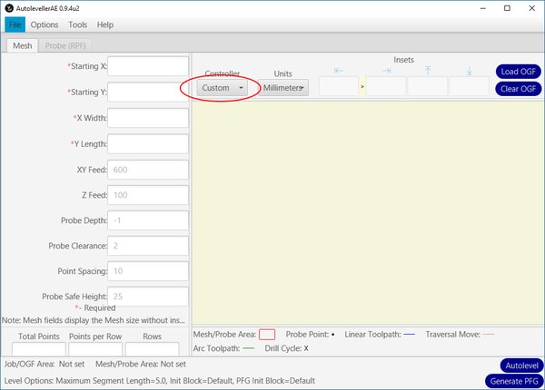

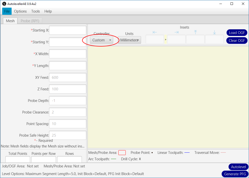

1. Do you mean the 'custom controller options'? Make sure you select 'custom' as the controller in the main window,
like this:
otherwise your custom settings wont be written to the GCode.

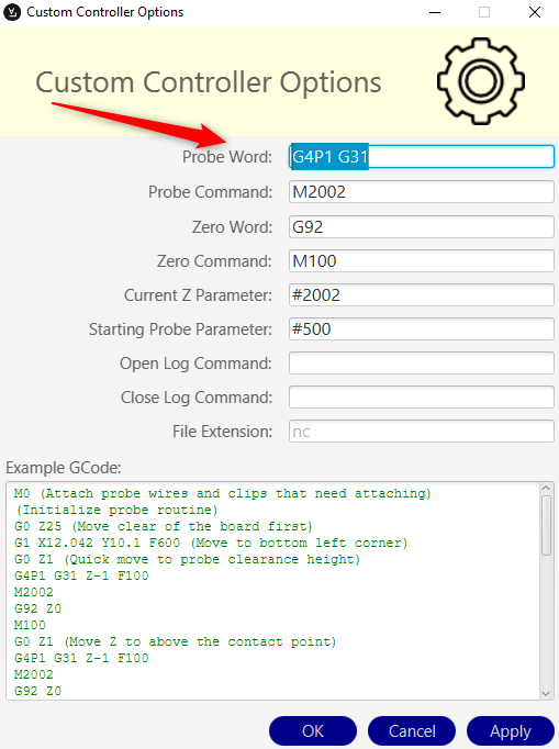

I'm starting to understand the GCODE a bit, for me it's a problem of speed execution so I looked for how to do a pose in GCODE.
So I included a line G4P1 just above the command line G31 Z-1 F10 now my CNC USB with MACH3 G31 Z-1 F10 well takes into account.
Is it possible to include this line in the CUSTOM?
I still have a problem with the return of Z which is 2 at the time of probing.
A ++
Daniel

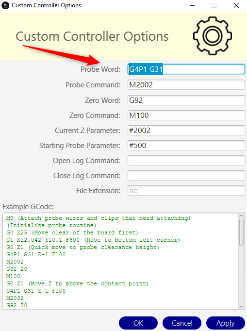

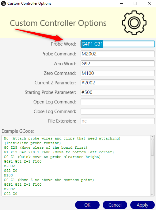

Hello,
I found to see photo attached.
Daniel
Re: MACH3FR CNC USB
Thats fantastic detective work, concluding you need a pause before each probe. Good job.
Also, thats a clever solution to add the G4P1 bit before the G31 in the 'custom controller options'. Good thinking :D
