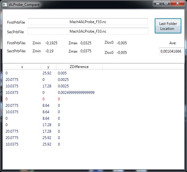

Anyway, at least there are no major problems now, however on comparing subsequent Mach probe values I'm getting an average variation of around 4 microns with a worst case 10 micron difference. The feedrate had to be lowered to 30mm/min to get such 'good' results (at 100mm/min was getting 30 micron average with highest around 70). Would this be considered ok on a generic chinese built cnc, or are the figures way off? Thanks again for the help.

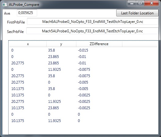

Actually the comparison was done between matching coordinates on two distinct probe files, rather than min/max values on the same probe file. Am assuming min to max is what you used given the large variations (0.26mm).
The idea was to keep comparing probe files until the differences were 'negligible' - for example the two test files here have variations of 15um at one point and 10um on the next two positions. Had just thought that 10, or even 5um differences are a bit much?
On edit: looking through a few of these, the smallest non-zero difference is always 2.5micron. I guess this is also the resolution of the machine.
That makes a lot more sense than comparing min/max in the same file as I was doing :) I hope to do similar experiments at some time, right now I do not have this information from my machine to hand.
I was thinking before about writing a quick program to compare RPF's like the one in your screenshot, or building it into AE in a separate 'RPF' tab sometime.
Did you make that comparison program?
It would be good if it showed the min and max Z values for individual files next to the average so the spikes I previously mentioned could easily be detected.

Apologies again for the long delay - was waiting for an isolation bit that took a bit longer than it should.
I did make the compare WPF app - and have added statistics for the individual files as suggested. Although trivial, the program has really helped me get a decent result now:-). Often have to probe 3-4 times in order to get the average down to <0.005mm. I would consider the code open source.

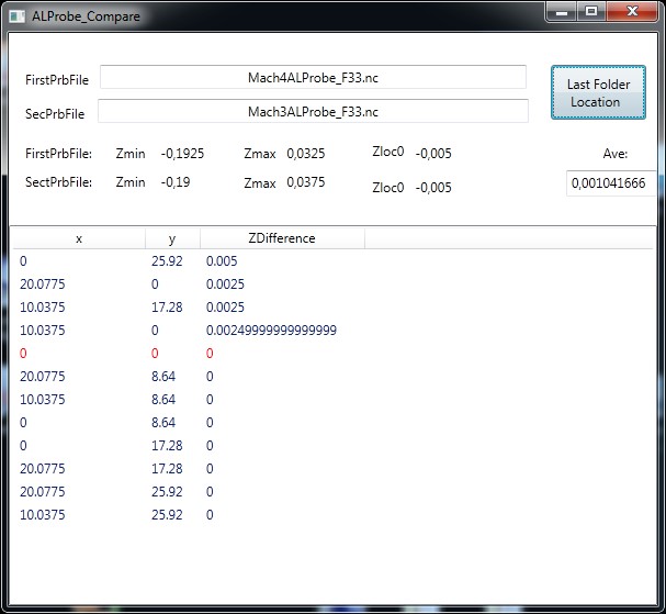

The app looks very useful indeed. I can see how this could help massively for diagnosing probe problems and I have been looking in to doing something similar for AE. My ideas are focused on getting stats for individual probe files so maybe I could link to your program if someone needs to compare files side by side?
I noticed from the screenshot that you are comparing a Mach 3 probe file with a Mach 4 one. If the Mach 4 gcodes are the same as Mach 3 then I dont see any reason why AL is not fully compatible with both? Did you need to make any changes to the gcode to make it work in Mach 4?
