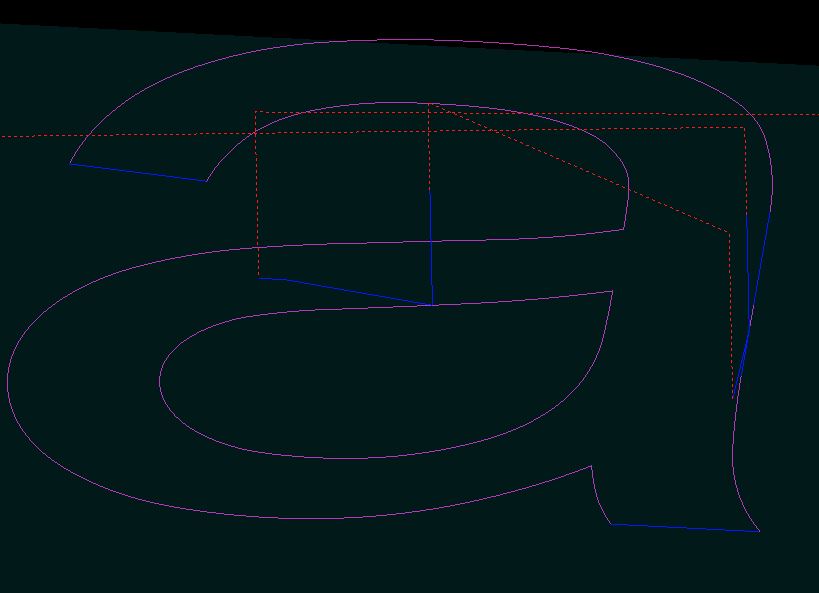

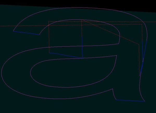

Re: NX CAM Output Problems with Autoleveller
Hi Country_Bubba,
Thanks for taking a look! I see what you're saying, but I believe that what you're referring to is the location where the ramp on shape starts to happen. There is a linear ramp to engage the cut that starts at "Z.01". Also, there is a Z0.1 clearance plane. Cuts are all made at "Z-.01". I think this is obscured because the engagement isn't just a direct Z move, but a more complicated linear move. N0200 is the ramp on shape move.
I added the comments above for clarity. It's good to hear about the sequence numbers. Playing around with the gcode, I couldn't get a clear indication of whether they were causing issues or not.

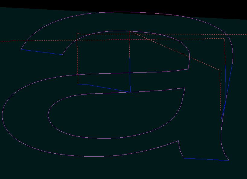

I attached a photo of the ramp on shape engagement into the "a". This is a screenshot from Mach3. Look at the center curve of the "a".
It's the easiest one to make out in the photo. Mach3 seems to have no issues with this toolpath at all.
Is this possibly a leading zeroes or trailing zeroes problem? I will play with it some more. Thanks again.

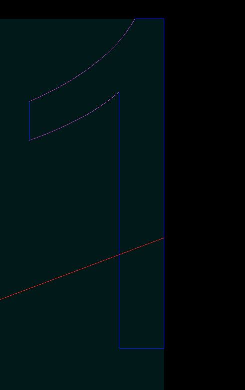

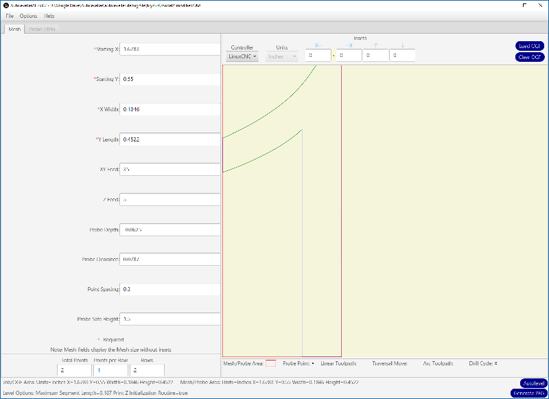

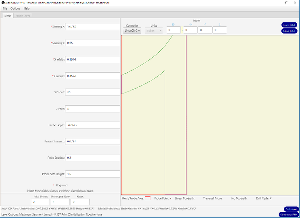

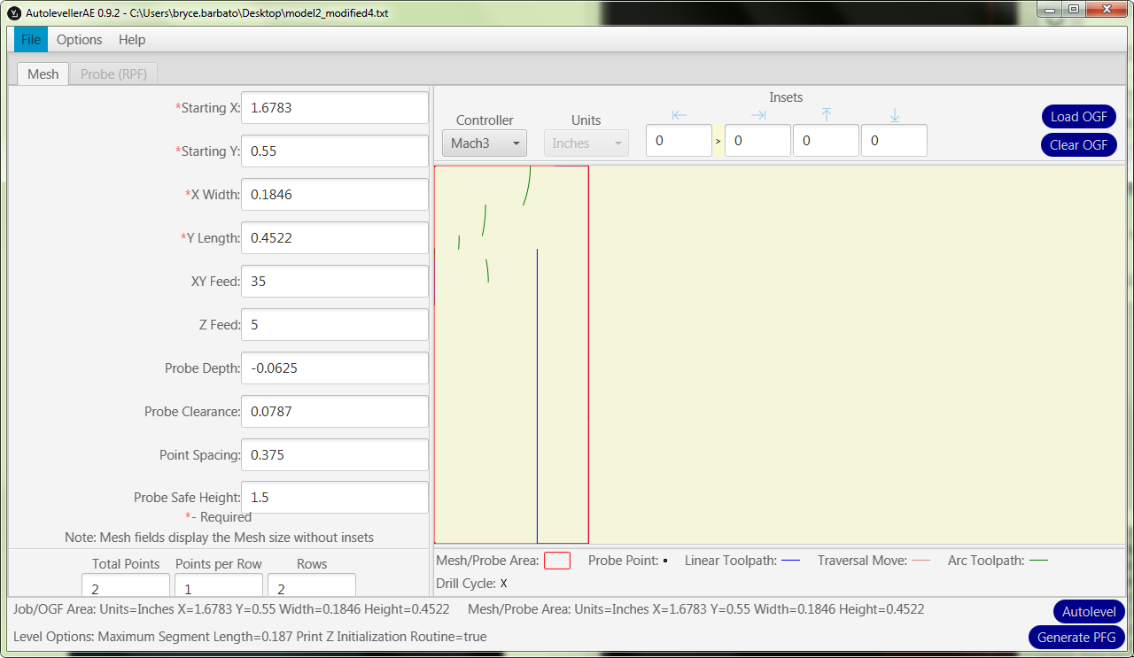

I played with it a little more. Here are the quirks that definitely cause problems:
- Leading zeroes before a "." are required
- Trailing zeroes after a "." are required
- G moves must have the Gcode present (for example, the current NX code omits these on lines where the gcode is the same as the previous one)
Other things:
- "%" does not seem to comment out a line (this might be an NX only thing; it appears that autoleveller uses "(" for comments)
Things that definitely do not cause problems:
- Sequence numbers (or their values)
So this, which does not work at all:
Becomes this, which kind of works:
So, to me it looks like arc interpretation is wrong in the Autoleveller preview window. I can't run the actual generated output right now, but it looks like the autolevelled code probably is correct. It doesn't modify the arc codes so all is good. Now I need to figure out how to adjust the NX CAM post for the changes mentioned above.
I have attached images of the Mach3 output of the model2_modified4.txt file and the resultant output display in autoleveller. There is only code for engraving a "1". The extents seem to be OK, but they might be wrong in the case that there aren't G01 or G00 commands near the extents of the workpiece. I'm not sure.
It would be nice if there was a formatting document that specifies any requirements for gcode generation. If one exists already, I apologize, I couldn't find it.
Thank goodness for Notepad++ that makes these edits relatively easy.
Country_Bubba, again thanks for your help. I suspect Camotics doesn't like some formatting of that first code either. Please try running it against the second code to see if it comes out right.
- Bryce

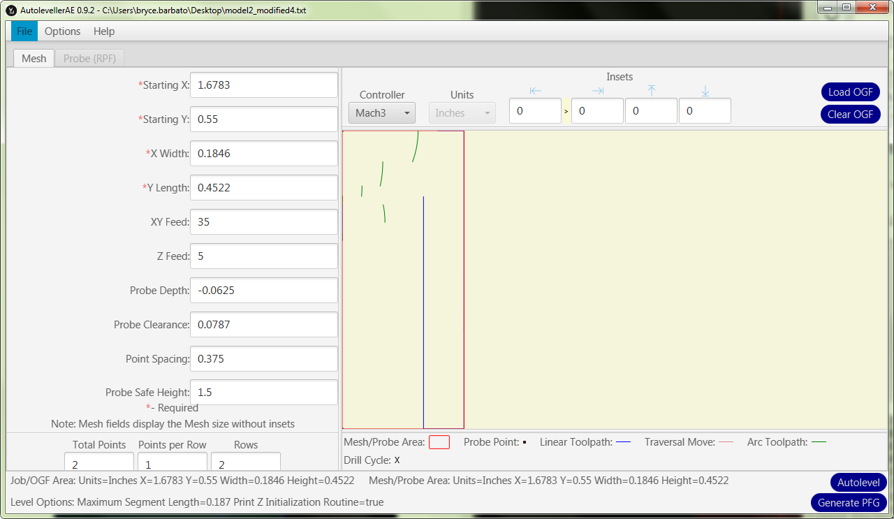

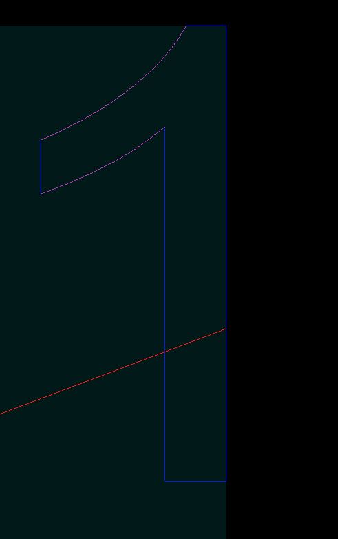

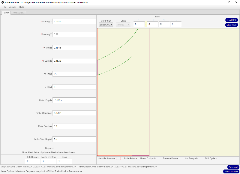

As requested, I ran your revised code and it worked a treat and gave me a beautiful "1"

Great! Good to hear it showed up correctly for you. Much of my debug was determining the difference between my Eagle gcode and the NX stuff.
Allow me to jump in here. I think yourself and Art pretty much have this sorted but there are a couple of points I need to clear up...
You are correct in your conclusion that AE does not like blank spaces before and after the decimal point and I can clear that up in the code fairly easily I hope. It should not matter if trailing/leading zeros are there or not. Stay tuned for the fix.
If you look closely at your modified file, you will see that the J words are missing leading 0's still. Re-adding 0's causes the viewer to draw arcs correctly as can be seen here:
So, actually the leading/trailing zero issue and the arc problem are one and the same thing.
Thanks for letting us know as it needed fixing
