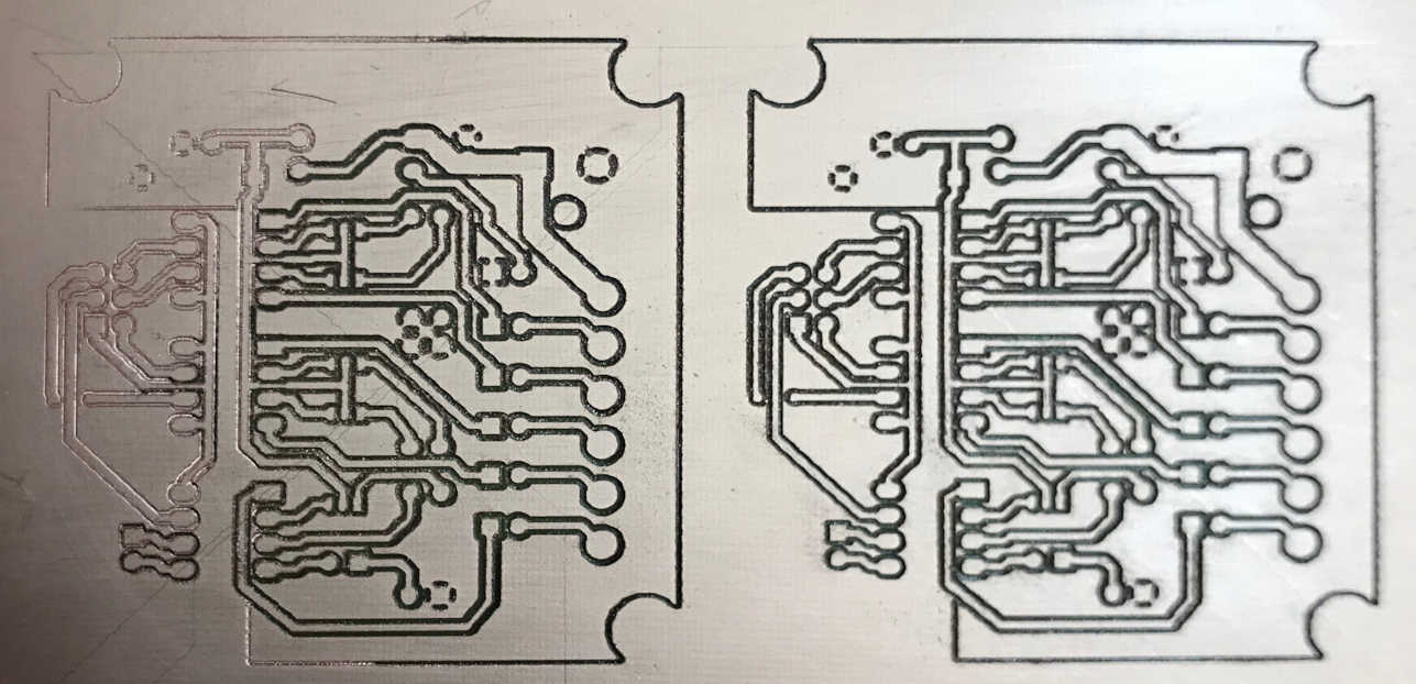

KiCAD: 4.0.7
FlatCAM: 8.5
Autoleveller Version: 0.9.3u1
LinuxCNC (current)
PCB mounted with double-stick tape, 3 peices, full length of the board. It is damn-well stuck down
I put a dial indicator on my machine and ensure the PCB is level across all 4 corners the lower-left corner (0,0) reads Zero on the dial indicator. The area with the air-cuts also reads 0 the top right is .003 high. I actually measure ON the PCB itself, not mounting board.
Probing at 0.15". Probing proceeds without incident. I use the actual cutting tool as the probe, so there is no tooling change between probing and milling.
The 80% of the board that milled correctly is perfect.
This has happened several times now, and I'm starting to get frustrated ruining PCB stock.
Ideas?

So, I THINK the issue was the double-stick tape approach.
It lifted a bit at one corner/end. The probing applies no pressure, so the probing couldn't detect any deflection.
Upon milling, however, the pcb just 'flexed' away from the tool.
I intend to try with a different, more secure clamping technique.

Okay, here's the latest.
Issue #1: Aircuts. I happened to visit a high-end cabinet shop. He has a large-format CNC router (like 6 x 12 feet). He used HOT GLUE (yes, hot-freakin' glue) to secure some smaller parts for milling - parts too small for the vacuum system to hold down.
So I put a weight on my PC board and used some globs of hot glue at each corner. Easy to remove, no clamps, no screws.
WORKED PERFECTLY. No air cuts. I intend to continue the Hot Glue Clamping System.
Issue 2: Problems with 0.9.5 were operator error. I was fooled since I could use my probe to zero my Z-axis on the PCB surface. In StepConf (LinuxCNC), I had the probe connected to Z-Home and not Probe-in. Made the change and all was good with the world.
