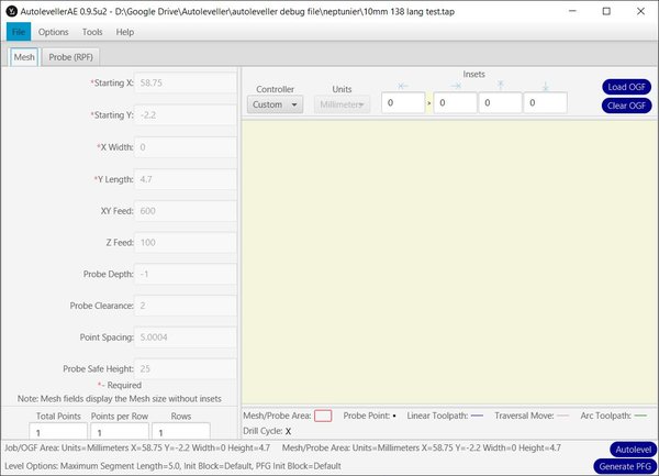

Hey Michael,
Thanks for all the information and files attached. It makes it much easier to diagnose.
I am using AE 0.9.5u2 which I presume you are too.
First I loaded the RPF file into AE which looked fine and as you described.
I then loaded the OGF into AE and expected to see a design in the drawing area, but was instead presented with this: Looks blank. Also, it detected the x-width is 0, so this would explain why nothing is drawn and also why levelling isnt performed properly. I then opened the OGF in a separate editor and again there was almost nothing there.
I then opened the file in a text editor and saw only a few lines of GCode:
Did you attach the wrong OGF or something?
