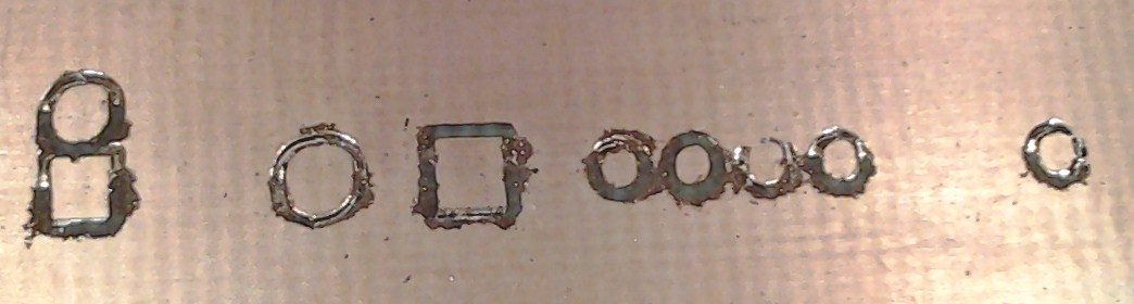

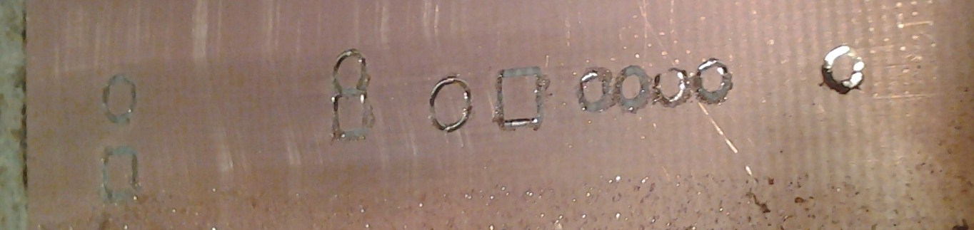

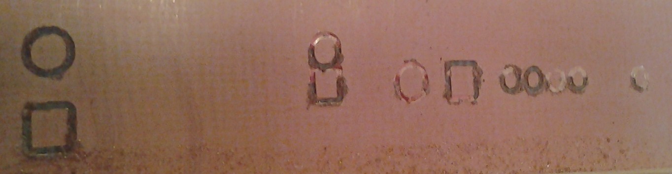

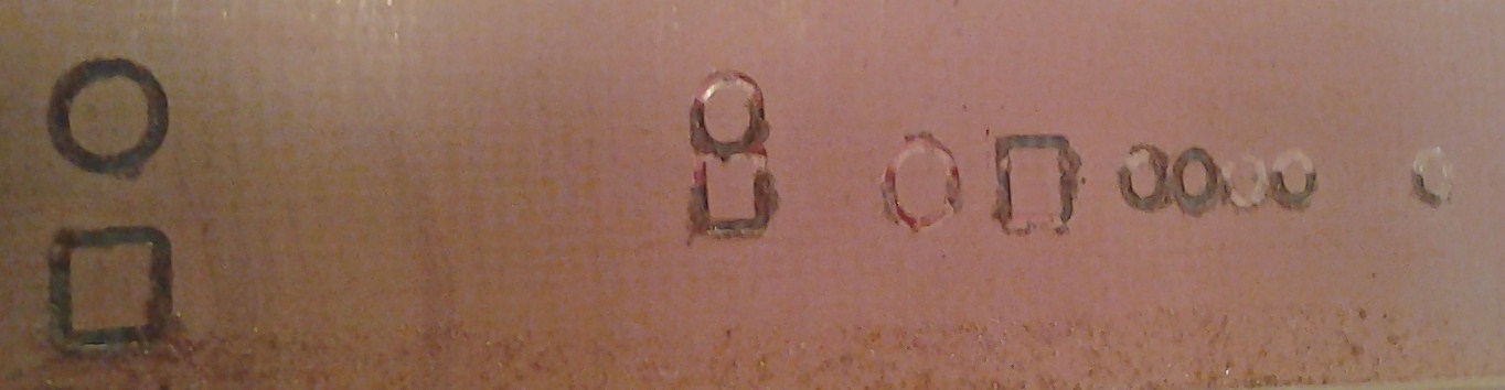

here are pictures of how it is cutting. I stopped it before it ruins the entire pcb blank

I think this could be for a number of reasons. A possibility could be an inaccuracy in the probing values retrieved, again the reasons for this could be numerous, could be something to do with anti-backlash nuts on your axis or some setting in Mach. I remember a problem a while ago that affected a few individuals where AL didnt like the probe values when fed back to AL because some values on the X and Y axis were slightly off. I adjusted AL to compensate but it would have been better if the machine had been 'tightened up' rather than the software working around the problem.
I did notice a few of these discrepancies in your log file but I'm not sure if its enough to affect anything. From your log file:
A couple of Y values are 0.44475 wheres they should be exactly the same as the others (0.44477). X and z could be worse, not sure. Again, dont know if these minor differences are enough to cause a problem.
Another thing which you could try is to increase the cut depth. I noticed your cut depth was set to .002", maybe try .004" and see if that helps.
If anyone has any other ideas, please chip in.

my backlash on all axis is less than .0001 checked.
I noticed while probing sometimes the x axis would move, don't know where that command is coming from. it would move maybe .001 to .002 occasionally. really weird and I thought it came from your software rewriting the gcode to do the probing.
I am going to add a capacitor to the probing leads to prevent false signals and prevent bounce, but other than that I don't have a clue either. This is the eighth machine I have build for cnc work. My other two big mills and lathes I still use are acurate withing .0005 when cutting metal, this one tested milling out objects is within .0002 so and I have not encounter the random x move when cutting other projects, just when probing with the autoleveller.

Very weird as you say, X should not budge during probing at all. Has anyone else experienced this?
As a suggestion, try generating a 'probe only' file in mm not inches and try that. It should not make a difference to the X axis but I would try anyway just to rule it out.
Maybe Mach rounds up some values when inches are used which might account for the X axis movement. Or maybe I am clutching at straws.
